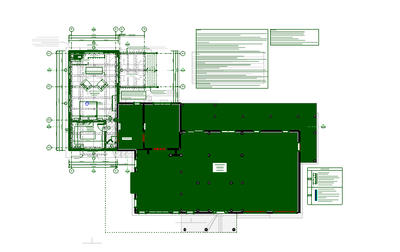

Hi, ArchiCAD ISSUE!!
All the colors in my drawing were fixed, and then all of the sudden everything changed to green.
Does any one know how I can get all of my selected colors back?

Most likely you have a Trace Reference active

jackie williams
I will look into that!

I had the same issue. Found out that it was a bug, and that changing renovation filter back and forth did the trick.
