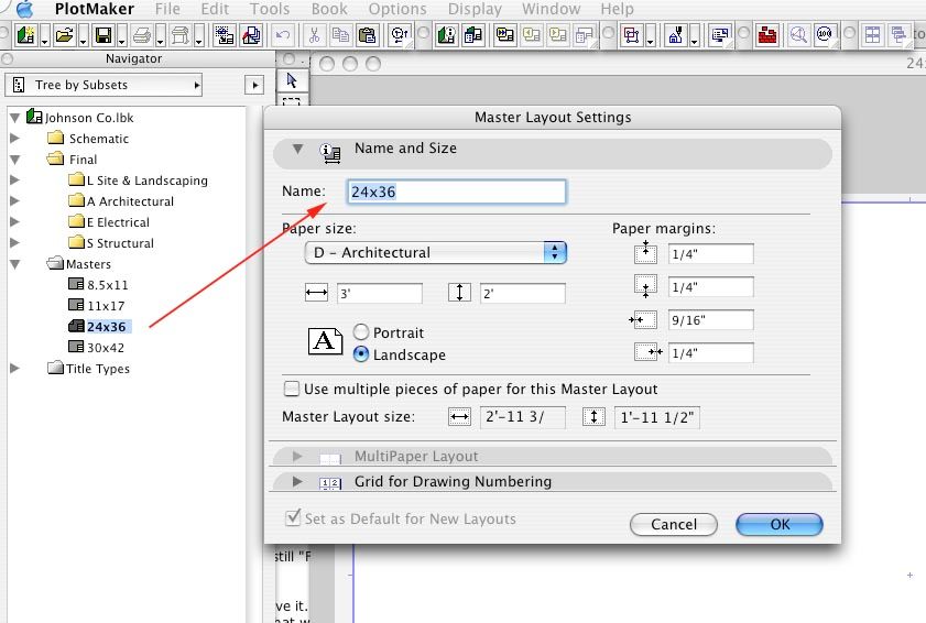

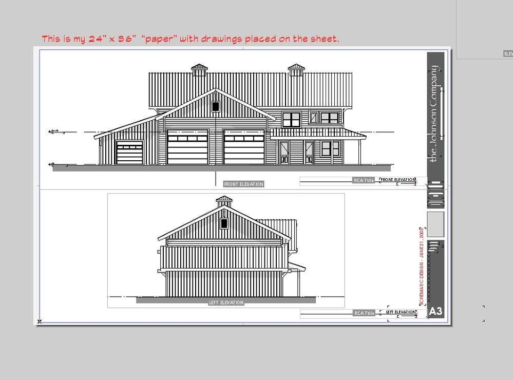

Attached is my 24" x 36" sheet settings.
You need to do this.... then apply it to the "Layout" your trying to print.
You should see your scale drawing paper with your drawings placed, just as you want it to print.
See the next screen shot........

Now in plotmaker go FILE> page setup
Select the paper size that corresponds to the sheet size your using plotmaker.
You will most likely need to create 24 x 36 as a custom paper size.
Do it by clicking the Settings bar (on the "page setup window) and hit "custom paper size", use the same size/margins you set in plot maker.
Get the orientation right.

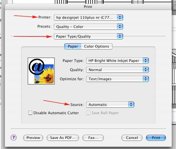

Now go FILE> print
Select the correct printer.
On the 3rd "pull down" tab.... scroll down to Plotmaker....
It will open a print options window.
You should be able to tell here wether or not you'll be printing to a single sheet or multiples.
If it shows multiple sheets... CHECK THE "USE MARGINS OF DEVICE" BUTTON.
Marc Corney, Architect
Red Canoe Architecture, P. A.
Stress Co_
One last thing to check is: Paper Type/quality...... make sure the Source is where you want your paper to come from.
When I do test plots.... I'll reuse the back of earlier test plots by selecting manual feed ... and hand feed the sheets (that paper don't grow on trees you know, Oh wait...it does).
That should get you there. Good luck.

Southpaw:
Link just straightened me out on a redundancy.
Set your paper size in: File> "Page setup"
Create your "Master Layout", selecting "Import settings from printer"
When you print, go Plotmaker Options> Print options> select "use margins of master layout".
Sorry if that was confusing.
