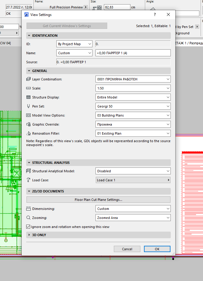

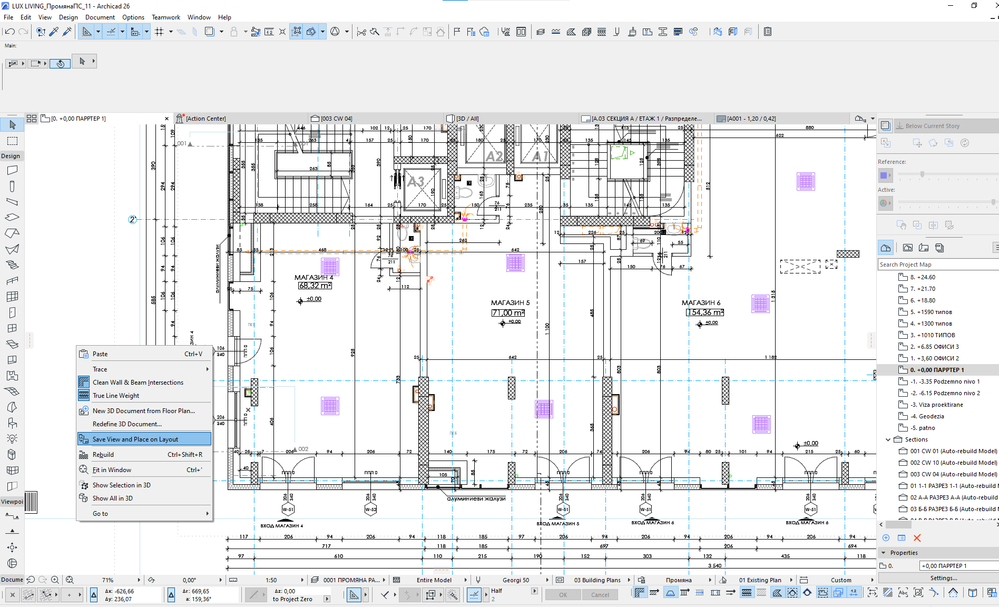

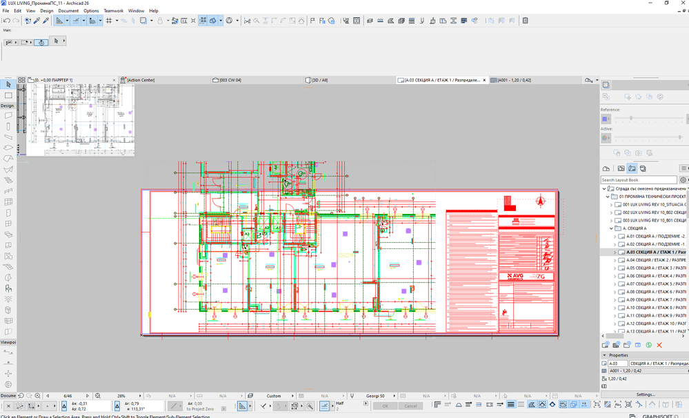

I am having the following problem with both AC 25 and AC 26. Saving a view or placing level from Model space to layout book changes the colors of it. When i check the view settings of the drawing in the layout book everythin is correct. Even if i try to change the colors of the drawing window nothing actually changes. Something went wrong with the file because i had previously set views with correct colors.
Any help is appriciated.

mija
Check drawing settings on layout. Could be a different pen set.
Go to layout >>> click the drawing >>> right click >>> drawing settings >>> pen set. Should be selected by source file / view.

Yes, this was the case. Thank you. That was fast reply.
