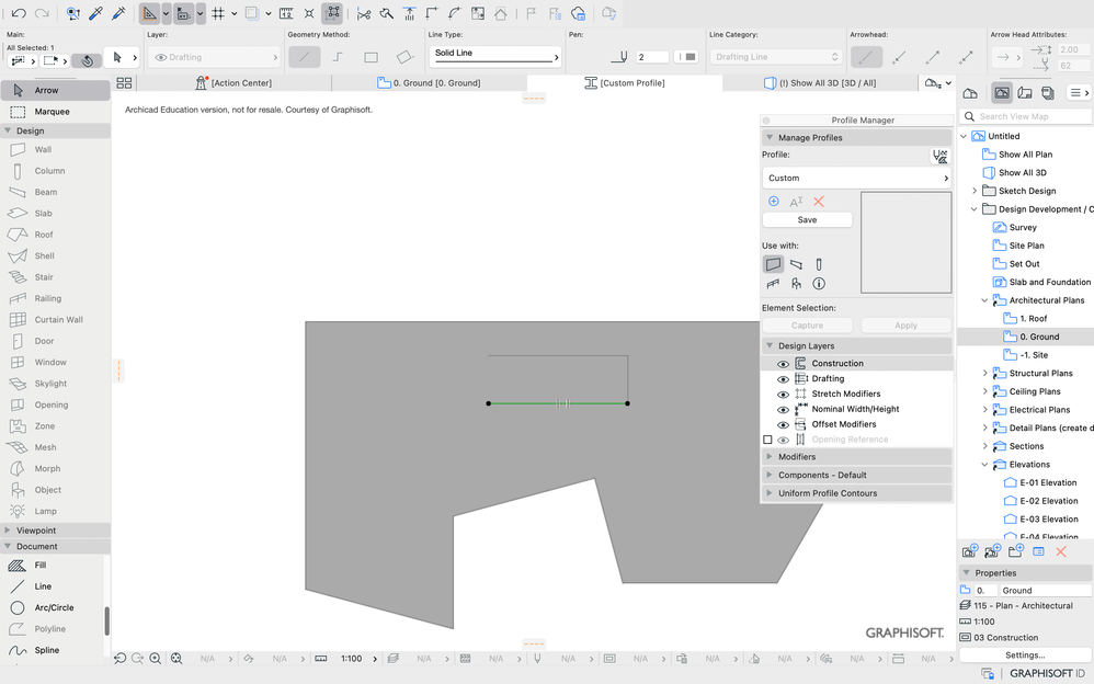

Hi there, I'm using the profile manager tools. I don't know how to remove the rectangular inside the shape. I'm going to have a rectangular hole in the middle of the shape.

Thanks for your response, Barry. I'm unable to create a hole. When I delete it, the shape is completely removed.

Open the profile in the profile manager.
It is just a polygon fill so use the pet palette option to cut a hole (remove an area) of the fill.

Select your grey shape, which is a Fill. Click on a node, swap to subtraction mode, then magic wand the rectangle.

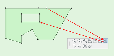

See my image.
Select the fill, left click on the perimeter and the pet palette will appear.
Choose the remove are option and now draw the area you want to remove.
