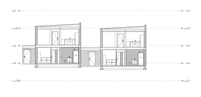

Hi everyone,
Thank you for the solutions for this, I have been working a lot trying to make the models to try out the way you’re describing. Mind you the models are far from finished, but I wanted to find my problems while the topic was still "hot"
However, I’m still struggling understanding the workflow when assembling the models into the master file.
The model file looks something like this - the section view, and the foundation plan.
I then made a copy of the model file, use hotlink to get in the models to the master file.
But here I have a few questions.
First off, I tried importing the models with all stories.
- I made the same number of stories as in the model file, but I didn’t change the story heights. Since I assume that isn’t relevant, since I will be using the story heights of the model file.
- In Place Hotlink window, I used the function for Keep Elevation as in Story Structure of Hotlink Source. / This might be wrong.
Regardless, the import went fine - and the section view looks like this now.
The house to right side is 350mm below the last one.
  1. First off I’m a wondering how to go about putting the stories on what level - I assume I have to put the foundation walls in the same story height, to be able to define a cut view within that story level.
 But as you move along, the first floor will go below a story - and you would have to define combination of showing the below story with a set cut plane - but you would then show information from the below story which is relevant for the plane.
  1. I understand, I must define a view for each house with different "Cut Plane" - which is what I did before - however, I don’t understand how you are to measure the totals of all the buildings, and doing diagonals between spots - when the plan view looks like this.
    It doesn’t show the outline of the foundation walls on the house that aren’t in the "Cut Plane."
    And what I end up with is still having to put together the views into the master layout.
This is correct, keep the storey structure of the hotlink so it doesn't change.
You will end up with a correct 3D model, but as you have discovered, because the floor heights for each module are different, you may not be able to use the same FPCP height across the entire model.
This is when I would link the plan drawings in the layouts to the external hotlink file.
That way you will see the plan cut at the exact level you want (with out having to do anything extra).
Crop the placed drawings and join them together to form one large plan.
I have never used Teamwork, so am unaware of any problems arising from that, that have been mentioned in earlier posts.
You could use multiple plan views with FPCP at different heights all in the master file.
Similar thing, you would place the drawing for each plan view on a layout, crop to show the correct plan for that FPCP height and join them together.
But I think this might get a bit confusing having 4 or 5 views of each storey (if you have 4 or 5 modules).
