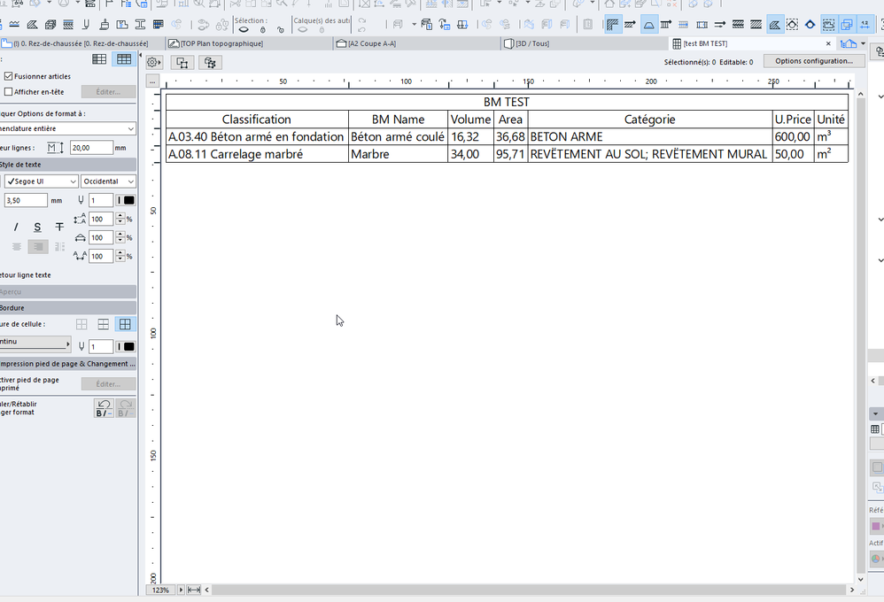

I am new from AC 20 to 25.  Providing detailed material list has been a vital part of my work. I have unfortunately discovered a bad bug (you can't link a composite to a property object) so support is suggesting I should go ahead and switch to Properties and Classifications for my needs, but, from what I see there is still no way to achieve what I can extract from Listing.  I am well aware GS is transitioning away from Listing, but after years there is still no other way to extract quantities like number of studs... LF plate etc.
So, has anyone achieved a detailed material list via Properties and Classifications like the attached pdf?  From my initial checking it out, I don't think so.  I'd love to be wrong and that it would be easy to incorporate into existing PLN's via the Migration assistant, but I don't think so.
Below is what I can get from basic Listing with an exterior wall by linking a property object (based on the data base).  It's also integrated into over 200 PLN's and the thought of reworked each one with a new system is a non-starter.  Listing needs to work despite it being decades since it has been updated, it still does the job.  I'll attach a typical material list I can easily generate via Listing.  Well, easy after years of setting things up.

You did not include your formulas -- so it's hard to tell. However, I would guess that most of the items above could be done with expressions and then just sum up all of the wall properties.
As a alternative one could use a Python script, gather all the info and do the calculations then print out your summaries to a PDF. The Python extension for the PDF is fpdf2. I believe possible formatting of the PDF would be equivalent to the Listing schedules

You can use properties to add custom data for your BM , and then scedule your BM

Thanks for the reply.  There is no formula involved, other than creating a data base linked property object and linking it to a wall, slab, object etc (screen shot below). Listing calculates the defined components and breaks them out and totals them as needed (4x8 sheets GWB... LF plate, etc).  I can't find any guidance of how to achieve that vis "Properties and Classifications".  You can not extract from the huge existing data base of components and descriptors with predefined quantities and units for calculations, based in a surface reference.  I know years ago when Listing was all there was we all complained about it, but honestly, it works great once you get everything set up.  The FAQ says >>>  Q -"Can I use component data for calculations. A - Building Material and Component listing parameters are not available in expressions as properties are implemented on element-level".  I would think if this can be achieved in a new way that someone would have done it by now.  Thus I asked here for a concrete comparison.  GS considers Listing Legacy and won't keep it up.  This is bad considering there does't seem any thing close to replace it with .. yet.

I use properties to quantity everything.
It's pretty easy once you get the hang of it.
Maybe search YouTube if nobody else responds, when I get a min I'll post a couple screen shots.
Rick Thompson
Thanks.. I'm now watching cantrabim now and it's helping.  Thanks for the encouragement:)  I am assuming I can use Properties to calculate 4x8 sheets from sq ft.. etc  Any screen shots appreciated.
