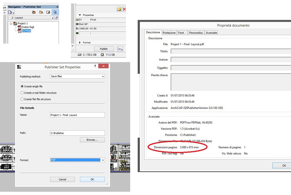

When I try to publish in pdf format a layout 1,060 x 91.50 cm (417" x 36") i get a 19,42 MB file with one white (empty) page size 508 x 91.5 cm (200" x 36").
How can I publish this layout in pdf format?

I just had more or less the same problem, I tried printing a 3.00m x 3.00m directly from my layout book but also ended up with a blank PDF.
I then tried saving the PDF directly from the Layout Book and it worked!
So select your Layout in the Layout Book, go to File > Save As and select your save options.
Hope this helps

tank for your answer, but for me not work; I always get a blank page.
thanks anyway
