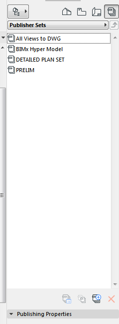

Silly question, But the publisher in my office template is missing all layouts to PDF, is there any way to re-add this without rebuilding the template?

I have moved your post to 'Construction Documentation' as it really had nothing to do with rendering.
There is no need to re-build the template.
You just need to create a new publisher set, add what you want and set the format to PDF.
You could even duplicate one of the other sets if they have what you want and just change the format to PDF.

Hi Barry
I was more meaning the "All layouts" which auto updates as you make new layouts.
Manually updated layouts are easy enough to make, its the auto update one.
Henry
Henry

In the organiser if you drag a layout from the left into the publisher set on the right it will just be a manual setup and you will have to adjust it yourself as layouts change.
However if you select the folder of layouts on the left and use the "Add Shortcuts" button at the bottom you will get a publisher set that automatically adjusts as you change the layouts.
