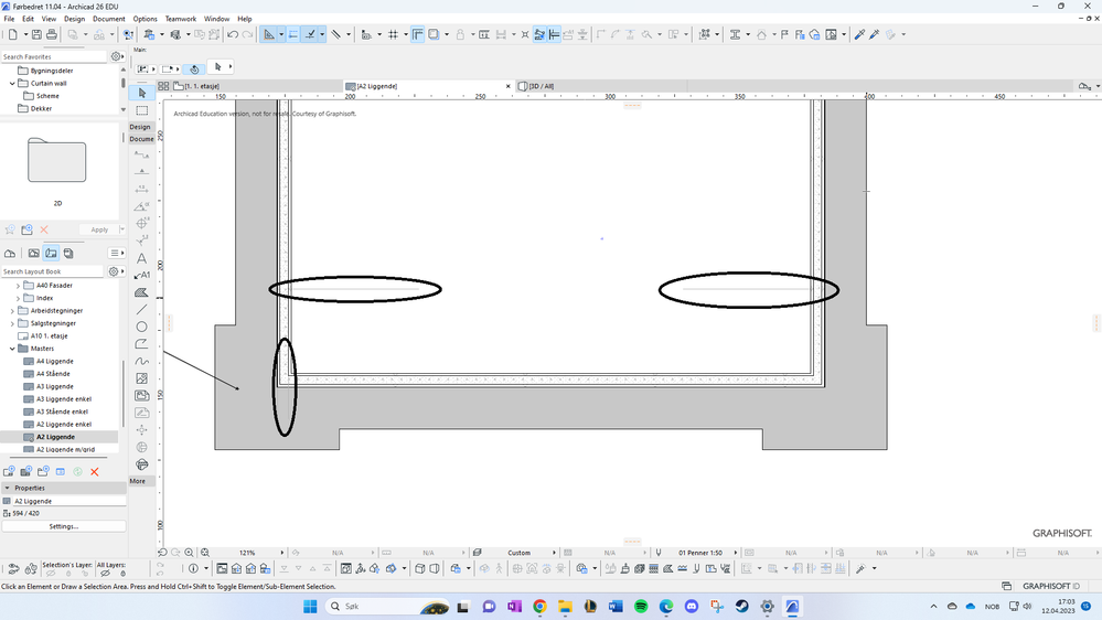

Hi!
When I copy my drawing from my plane to layout, there are these arrows showing in the copy on the layout. These lines are not present in normal plane view. How do i remove them? See picture for visualization of problem.

Trenneth:
I think those are Fill Handles, they can be turned off with the View > On-Screen View Options > Fill Handles command.

Trenneth
Thanks! That helped!
