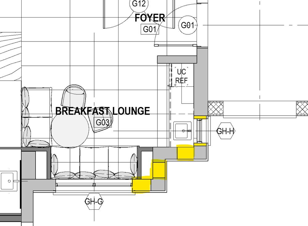

I am trying to get my plans to read so that all existing walls read with a 25% fill and my new walls to read with their typical fill, i.e., CMU, wood, stone. I would like the new infill to read as a 50% fill; right now, they are reading as no fill/white fill. (shown highlighted in the screenshot)
If I choose New Override in the Reno filter, it will override all my new walls, which is not what I want.
Is there a way I can specifically override the new infill within the existing wall with a graphic override?

What are your Renovation Filter settings set to?
Whenever you apply an override, it will always apply to the whole element.
Is it an option for you to model those infills as separate walls? Then you can create an override for those specifically.

I figured it out. Still working through how best to display all the information though. It had to do with the type of Building Material the existing wall was made from.
