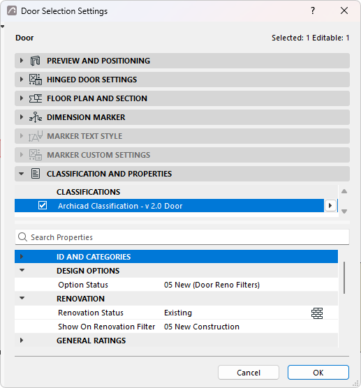

Hi @BIK,
As @Lingwisyer said, there's no official solution for this case, but you can try this one, it may be practical.
-I made 7 copies of the door, adjusted their settings to be as follow,
#3 of them represent only the door frame,
#2 of them represent the existing door leaf with (90°) 2D opening angle
& #2 of them represent the new door leaf with (45°) 2D opening angle.

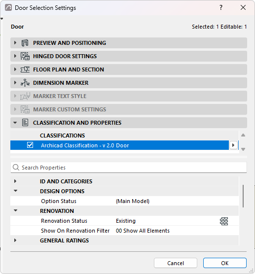

-I made 4 Phases for the door element using a combination of (Reno Filters & Design Options) as follow,
*In normal case, the original complete door is set to be shown in (00 Show All Elements-Reno Filter & Main Model-Design Option).

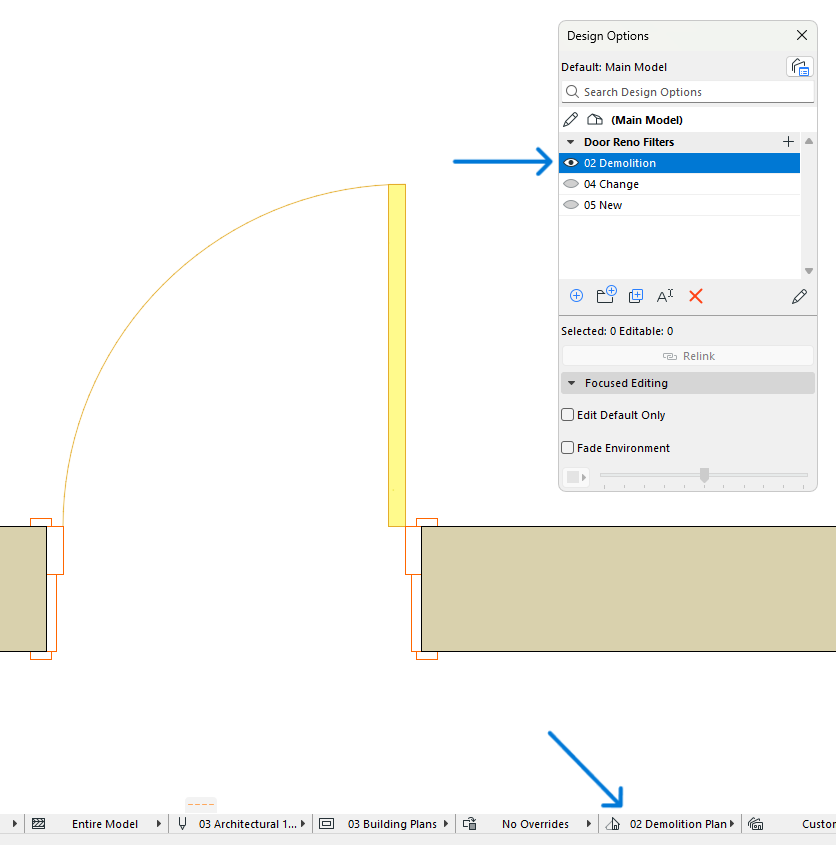

**(1) frame set as Existing ...
& (1) leaf set as To Be Demolished ...
Are set to be shown only in (02 Demolition Plan-Reno Filter)
& linked to (02 Demolition-Design Option).

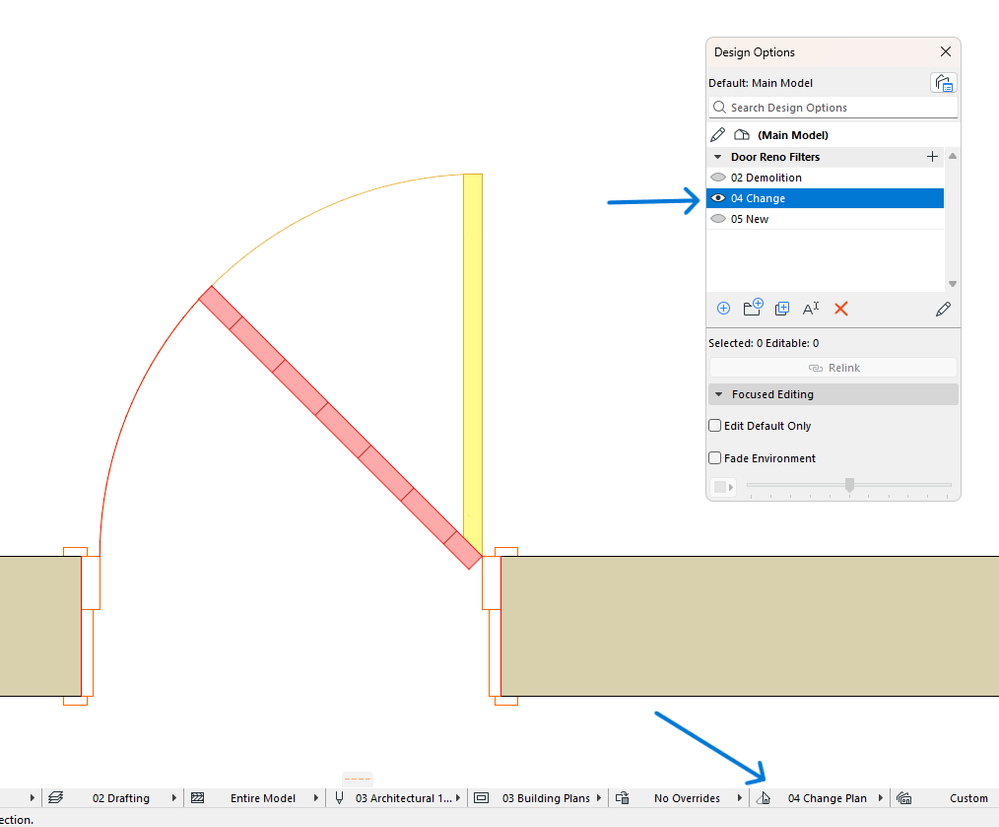

***(1) frame set as Existing ...
& (1) leaf set as New ...
Are set to be shown only in (04 Change Plan-Reno Filter)
& linked to (04 Change-Design Option).
****(1) frame set as Existing ...
& (1) leaf set as New) ...
Are set to be shown only in (05 New Construction-Reno Filter)
& linked to (05 New-Design Option).
