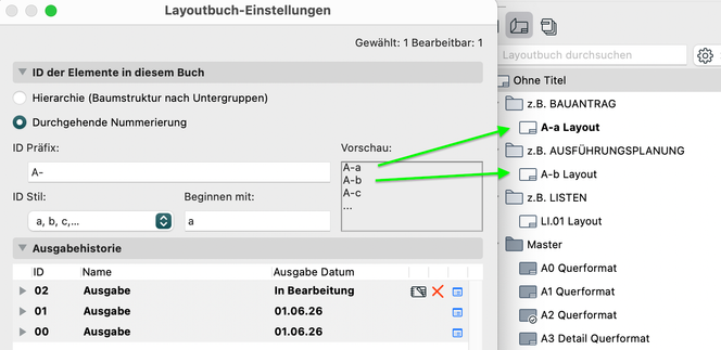

runxel
I think there are some misunderstandings here.
Maybe also from my side, so please bear with me.
So first of all, the tabs have nothing to do with each other.
The "IDs of items in this book" control the Layout IDs. That's it.
Transmittal history is something else.
Second of all: Of course it's possible to have the same ID (layout revision) in different transmittals....
Third of all: The ID of the transmittal is controlled implicitly: If you start with the first one being a "A", the next one will be automatically "B". If its a number, it will increment. I use exclusively alphabetical IDs for my layout revisions, and numbers for the transmittals, so that these never will be confused.
The transmittal ID is not really used anywhere, at least by me. It's just a counter, but I ignore it. Maybe there is a use case I do not see, but only the revision IDs of the layouts themself are of importance.

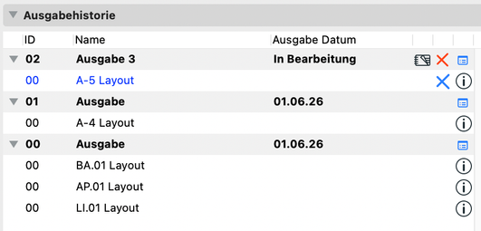

Please tell me how exactly did you get the Layout Revision IDs in this screenshot to all show "00"?
In my post & comment outlines my new project file with clean / new Transmittals keep starting Revision IDs at "01" and then increments normally from there.
I hope it's without needing activating the Override Revision Numbers tick box.

runxel
You're welcome.
Like I said, there is no way to explicitely make a rule. Instead you have to make the first index manually. There is no other way. So you must set it.
You have to go to the layout (or do it through the schedule) and edit it the ID there:
That's all there is to it.

runxel
Maybe I explained myself not well enough, but I did not use the "Override" button. Instead I make a new transmittal. The new, open transmittal will be filled with all layouts at first. Now, in the German version the default is that everyone starts on index "A". Let's presume that I want a numerical index instead.
I have to go to the layout, open its settings. Then I can change it to lets say "00" manually. Next time there is a change it will now automatically increment to "01".
Of course, if there is a change and you still want the same index?.... That's very obviously not possible. It would be deceitful anyway.
