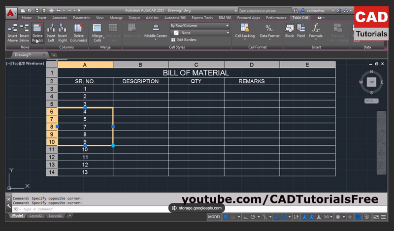

Cant find anything online or chatgbt to make row/column table on layouts... anyone?
2 ACCEPTED SOLUTIONS
Solution
If you mean schedules like door list then put the schedules on the layout.
If you mean excel like spreadsheets with calculations... no native solution in Archicad.

As Karsten said, there is not really a "table" solution in Archicad right now, but honestly that is not needed either.
Have a look at "Schedules" in the manual – those are really powerful can be placed on a layout, too! (Just drag&drop in the navigator)
If you need free text, that is possible with a "custom text"-column as well. But mostly you would want for every information to come straight from the model anyway.

Basically, ive researched online but cant conclude ways to do a simple table like shown in screenshot attached.
Any help would be great!

I get you now. Schedule not for windows but more for building key, loads of text and what not. Didnt know i could drag em on a layout, ive tried em but not familiar and time ticks quick haha. New about 2 months or so, and can use it as a base model only, and draft on top of it in detail or section. Any better way of doing details in 3D? Is morphing details in section view the best way to go about it? (cant screenshot the model due to sensitive nature)
If you have a lot of text or info that is not derived from the model it might make sense to rather export a PDF from e.g. Excel. You can place external PDF sheets on your layouts as well! They will luckily also export just fine, so text is still text in the final PDF export (meaning it does not get rendered into a pixel mush).
But that really depends on the content, and what you want to do with it in the long run. Many paths lead to Rome.
Of course you can also just fake a table with lines and text. šŸ˜„
You could also have a look at the new keynote tool – you can generate a table structure with the fitting object.
