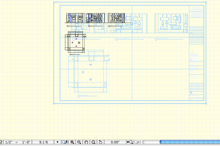

Not sure what's going on here and hope to get some answer...
The drawing [worksheet] is set to 1/2" scale and my layout is also set to 1/2" scale. When I placed the layout trace onto my worksheet drawing, they don't match.... what am I missing here ?

I've come across this glitch, but it is only a glitch. I think you can shake it by switching the reference with active, or another viewpoint, changing the scale, turning off the trace reference and/or holding your tongue the right way.

Also resetting reference to Original Position fixes it too.
