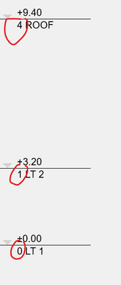

I am trying to use the story level tool in Section settings. I see that there are options to use automated elevation names and also to customize them. What I am trying to achieve is custom next to each floor such as "T.O. SLAB" for basement and "T.O. F F" for the next story. Bu using the custom name tool, it automatically changes the name for every floor and that is not what I want. I attaching a screen shot of what I would like to get if possible. As a current solution I have added a text element next to the story level marker.

I don't think this is possible with any of the built-in story level markers. They all pull information from the story settings (story name and elevation) and there are no options for adding custom information for independent stories. The only way is to add this information to the story name or adding custom text like you did.

Hello may i ask how you remove the story numbers on you annotations?
Lingwisyer
Guru
I do not use the OTB storey marker, but it is probably the "Story Index Text"
Story Levels Symbol and Text => Story Marker Text... => Story Index Text
