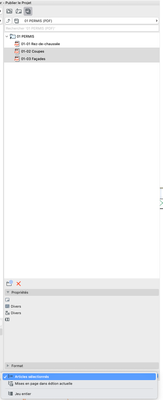

We often do a 'save as' on layouts to generate a single PDF or a small group of selected layouts in the navigator, for quick output of relevant information.
The setting in the snip below does stick for your current session, though it doesn't stick with Work Environment Profiles and i find it cumbersome to have to set this as often as i do.
The Entire Layout option is perhaps redundant? It could read 'Entire Layout(s) Selected in Navigator'. After-all how often does a user select a different layout before hitting Save As?

Why don't you create a publication set for that purpose ?
All settings will be saved.
If you don't want to publish all elements you just need to select some in the set and to publish selected elements only.

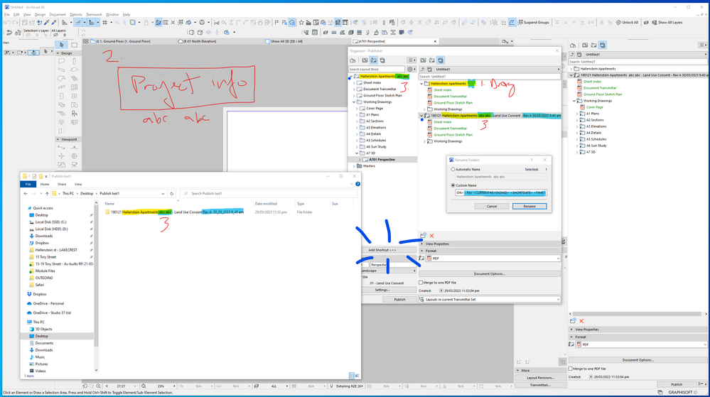

Okay i stumbled upon some info in the forums (sometimes the right information shows up as if by magic) and it turns out ive been using the publisher incorrectly for the last 5 years!
I've been dragging the layout book over to my publisher set creating a 'dumb' folder structure (in conjunction with publishing layouts in current transmittal set). The whole time I assumed that 'dragging' and using the 'add shortcut' button functioned in the same manner.
It turns out, the add shortcut button creates a 'live' folder structure in your publisher set and it automatically updates itself when you add a new layout to your book. For example a new sheet of details created in the layout book will add itself to the publisher set, and presumably all that's left to do at that point is add it to the transmittal list.
The kicker is that the dumb folder structure doesnt allow for autotext eg date time and other autotext entries from project info, where as the live structure does. Hopefully my snip illustrates this well enough.
So it turns out the ability to publish in a non-laborious manner and without the risk of overwritting has been hiding in plain sight this whole time. Dang
