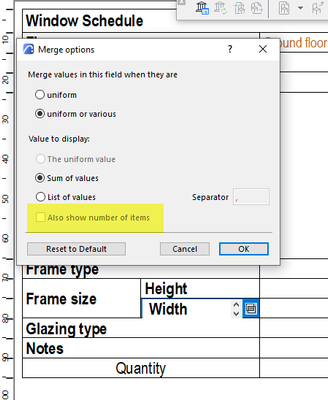

Hi all,
I'm preparing some templates for Archicad 25, and trying to use schedule merge option, new feature available, but when I hover on the row I want to put on merge, and change merge options, that button doesn't appear. Any advice what can be. Neither click + hover on the filed doesn't make button appear. Thanks!!
4 REPLIES 4
You have to make sure you have the 'merge items' box ticked before you can start merging the cells.
Hi Barry. Thanks for your reply, but I forgot to mention that I had activated the Merge option. So, any other advice!? 🙂 tnx.
Quantity is not a field you can merge.
It is a unique count of the number of items you have - it would make no sense to merge it.
You can merge other fields and there is an option to show the number of items you have merged - in effect the quantity.
Thanks for your reply, but seems that problem was version of AC25, latest update is showing merge option, which was the problem, I wasn't able to see it.
