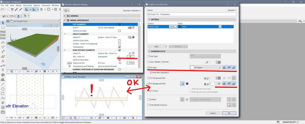

On my layout sheet, I have several elevation (or section) views superimposed on each other.
But one view showed me some strange white stripe, covering other drawings.
I think it's the fault of the elevation/section settings in the FADE DISTANT ELEMENTS tab.
I don't know why but these elevation/section settings have higher priority than the Graphical Override Rules settings. This is probably a program error.
I show this with a simple example. I deliberately drew a polyline in the elevation/section and placed it at the bottom of other elements.
When an elevation/section in FADE DISTANT ELEMENTS has Window Background enabled, the Graphical Override Rules settings are not recognized (and a covering white band appears):
To bypass the problem, you need to enable Transparent in FADE DISTANT ELEMENTS, then the Graphical Override Rules settings will take full effect:

What are you trying to override with the Graphic Override (GO)?
The criterion in your Graphic Override Dialog above says you are overriding Zones. I suppose that is not what you wish to do. Maybe this is why the GO is not working.
gaba
There it is set: "is NOT" Zone... 🙂
But it doesn't matter anyway!
If you set "Element type is: All Types" the effect will be the same! ☹️
I generally use this to hide all view fills on section/elevation.
Then I attach the settings show cross-sectional fills only, etc.
In the example I show a more simplified GO where you can already see that these settings do not overwrite the section/elevation settings when Window Background enabled in FADE DISTANT ELEMENTS.
