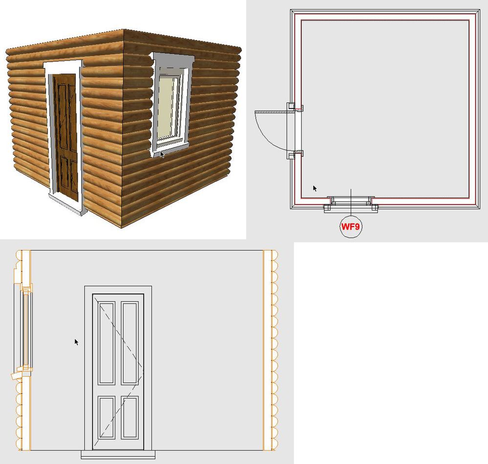

cadimage's accessory tools have a log function (amongst many many other fantastic features) . . . .
some 3D options ...........

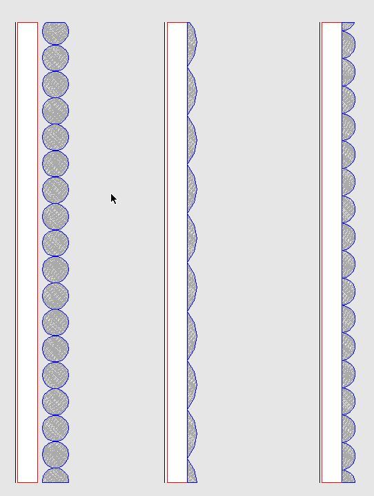

section display .............
(you can set air gap, log size (diameter), thickness used as a cladding, set-out point, materials, 2D fills & pens, etc . . .

and i just re-read your post again:
because this object is an accessory, it recognises any windows and doors that you have placed in your stud wall already and allows you to choose facing elements for those windows and doors that will be built as a part of the cladding . . .
(it's good! )

just because it's really easy to put something like that together very quickly, i did the attached. 2-3 minutes. it took longer to collage it in photoshop. bear in mind that i wasn't too fussy with the more detailed settings of door/window sections . . .
it's a tool that is incredibly useful. it's changed my whole approach to archiCAD - i simply model the structural depth in walls, slabs and roofs now and then use the cadimage accessories to clad it. no messing with loads of archiCAD walls to try and achieve claddings and linings.
job done. and for it's price it'll save you money by the end of the week!
