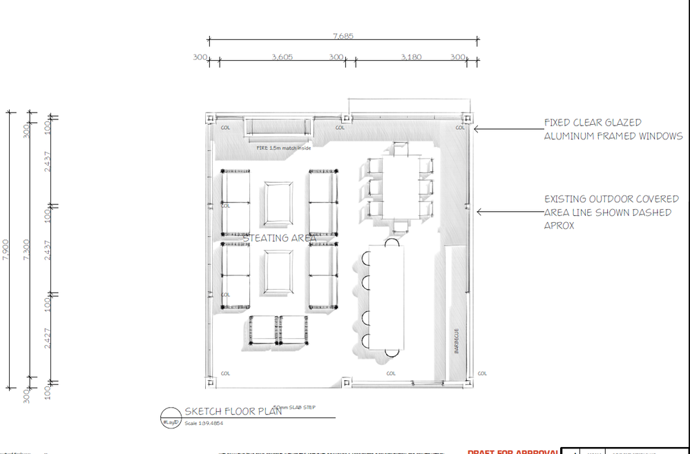

Have a look at this floor plan I did yesterday for a prelim.
So I've got a sketch rendered floor plan scaled... then I've got my floor plan over layed with all my notes at scale 1:50.
Though you'll notice my render says 1:39.
I don't particularly like this method, I'm currently trying to find a way so that it comes out at the right scale.
This way you would get your shadows.
