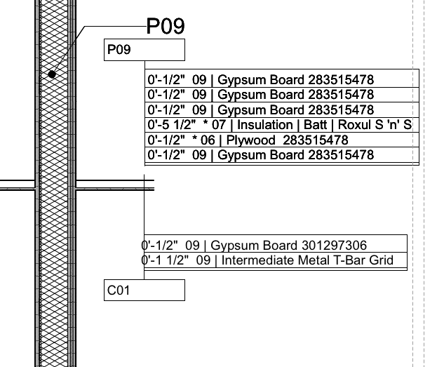

Please refer to attached file. For the two instances of Skin list label 19 shown I have Frame selected with an off-set of 3.0 pt. I cannot seem to get the off-set to apply at the left hand side of C01.
Additionally, I have the Working Units under Preferences set to 1/8" because there is a lot of 5/8" wallboard on the project. the P09 and C01 composites show all wallboard as 5/8" thick but the file shows it all at 1/2".
I am quite lost; assistance will be greatly appreciated. Thanks

Michael wrote:
Additionally, I have the Working Units under Preferences set to 18" because there is a lot of 5/8" wallboard on the project. the P09 and C01 composites show all wallboard as 5/8" thick but the file shows it all at 1/2".
This setting is at Preferences > Dimensions > Linear Dimensions. These settings are part of the View Settings.
This may be a bug in the script of the Label. I could reproduce it in ARCHICAD.
Basically the P09 Label's Orientation is set to Horizontal, while the C01 Label's Orientation is set to Custom, and the Flipped checkbox is checked, if I am not mistaken. In this case the Label text does not fit into the Frame. Probably the script incorrectly calculates the text position in this case.
I will forward this to GRAPHISOFT.

Hi Guys, this is indeed a bug. We have recorded it. Thanks for sharing it with us!! best, k
