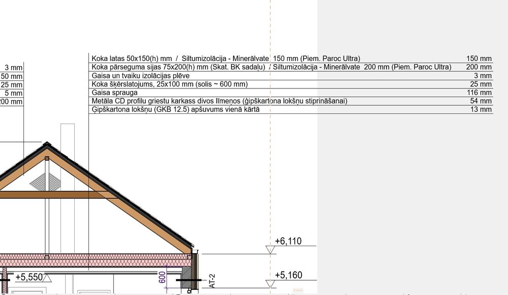

Sometimes the skin list contains a material that has a longer description and can't fit on a single line, otherwise it wouldn't fit a layout.
I did find a similar issue when searching info on this topic, found it here from 2021, has anything changed?

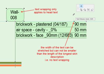

Picture for attention, what I'm trying to do. Or is this not possible?
I only have version 25 open at the moment, but it appears that the descriptive text can only be adjusted to the length of the longest description.
It will not allow for the descriptive text to be wrapped.
