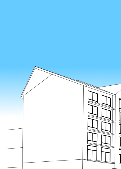

You can place an image using the Drawing tool or the Figure tool and send to back in display order. I have done this in the past with a percentage fill or gradient fill over it too, to fade it out a bit so its not too dominant, but the example below is just an image from the Archicad background images library.
