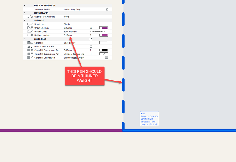

Slab separation lines
This is a bug (well, a feature that doesn't quite work right):  the dashed slab separation line between slabs will use the correct linetype, and correct pen colour (Hidden Line settings)...but NOT the correct pen weight.  It will inherit the pen weight from the slab Uncut Line pen, not the Hidden Line Pen.
