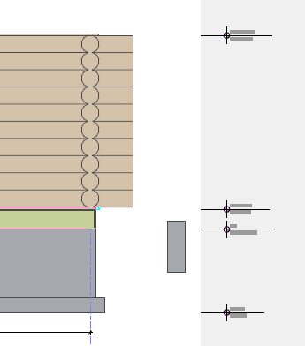

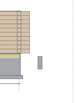

how do i show story levels in elevation layout book when i can modify and show them in elevation view map. are elevations not the same when discussing elevations? what am i missing? the views have the same darn "exterior elevation" combinations.

Check your elevation settings.
You probably have the storey markers set to 'Display Only'.
You want 'Display & Output'.

They really need to have "Display Only" elements made a different colour...
