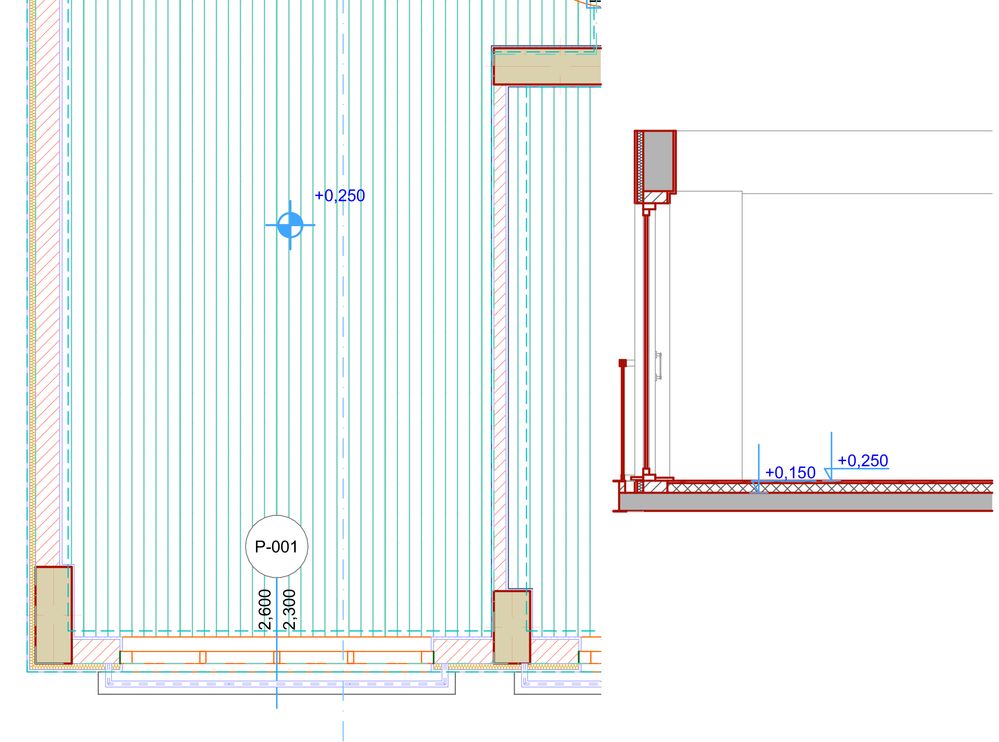

Hey, as indicated in the section, the structural floor level is defined as +0.15, and the finished floor level is defined as +0.25. is It possible to represent both of these levels on the plan ?
Thank you in advance for your responses.

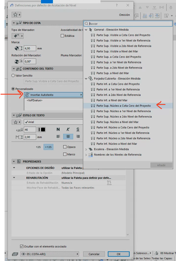

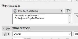

Maybe you are looking for this autotext?

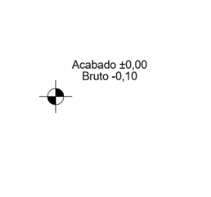

Cazer_36
Yes, absolutely this!  Thank you for taking the time to respond 😀
