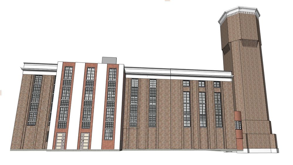

When i exporting in IFC,  surface material not going same as model surface material. It's taking same as building material. So Is it possible to export surface material in IFC? Could you please suggest setting of IFC translator?

Unfortunately Archicad (and most other software exept BlenderBIM) does not support the texture part of the IFC schema. So there is not anything you can do with the translator to get the textures in the IFC file.
