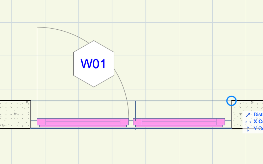

Hi All,
Hopefully, somebody can help me with this Terrace Door 25, I can´t remove or change the uncut fill pen, in this case, color pink. I review all 2D Settings for the door, but nothing seems to work. Any tip would be very helpful.
Thanks!! Best Regards.

I think there is a bug in the GDL script of this element. Some of the settings for the background fills don't work as they should. Maybe somebody with more GDL knowledge can look into this?
As a workaround solution you could change the pen nr. 19 color in your used pen set. I guess it is set to pink right now?

Is this happening with all doors or only for Terrace Door? Have you tried to open the same file on some other computer?

Hi Rajesh only with this Door, No I haven´t try it, will do.  Thanks.
Hi Miha, that could work! thanks. I really don´t use the pen 19 a lot.
