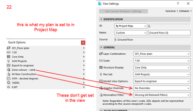

I can't seem to find the answer to this one issue I have with the workflow of placing drawings into layouts.

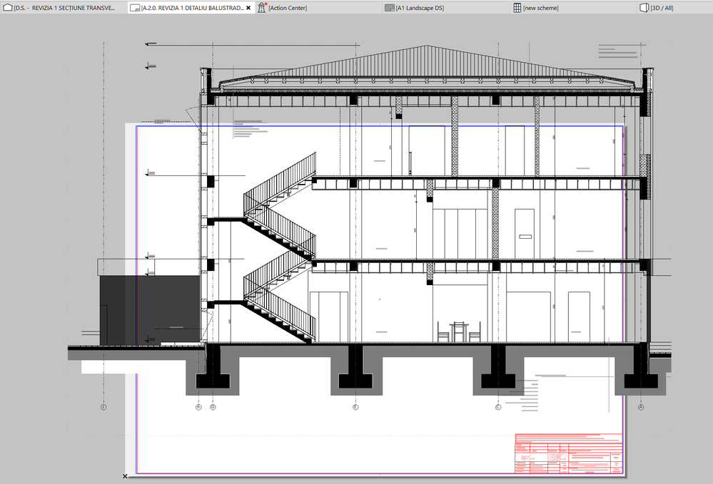

In Archicad 22 when placing a drawing onto the layout, the view would automatically have all settings as in my plan/section drawing ( same layer combination, same pen sets, same renovation filter, etc...). The system was perfect for me and everything was easy.

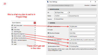

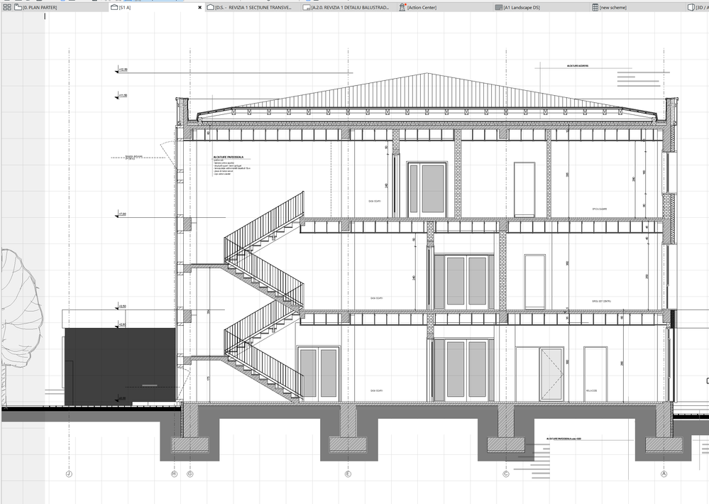

In Archicad 23 when placing a drawing onto the layout the view has to manually be adjusted to fit what I could see in the plan/section view...
Is there a way to make placing the views into layouts work like in Archicad 22? Make them automatically use the settings last used on said drawing before placement?
It seems like such overkill to make the user set everything twice...

I have done some experimenting and there does seem to be a difference between 22 & 23.
Neither works perfectly when you drag a Project Map view point onto a layout.
In 22 when I drag my ground floor to a layout 2 of the settings do not get set properly in the created view.
In 23 there are 4 settings that do not get set properly.
