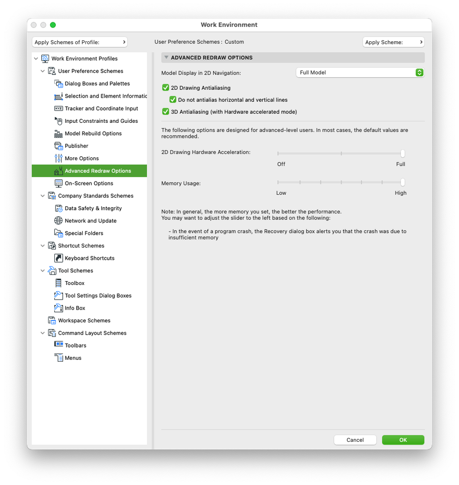

Having bunch of trouble lately with annnotation labels text not fully showing, depending on zooming in and out.
Screen Shot 2022-04-28 at 1.20.32 PM.pngScreen Shot 2022-04-28 at 1.20.27 PM.png
I've been switching from a 4K LG display to an older non 4K display, seems to happen on both displays.
My settings seem good here, based on this article
https://community.Graphisoft.com/t5/Setup-License-articles/High-Resolution-Display-Compatibility/ta-...
Archicad v26, MacBook Pro, MacOS 13 Ventura, AMD Radeon Pro 5500M 8GB, RAM 64GB, Non-SSA, Twinmotion User

Your description seems to be similar to what is described here: Text disappears in AC25 when zoom?
If that's the case, setting 2D Hardware Acceleration to Off can help with the issue.
Please let me know how it goes!

ethanbodnar
Thanks for the note. No, I'm not using display scaling, hmm
ethanbodnar
So unfourtunately this is the solution, but it makes Archicad as a whole unsusable. It madei t feel like I was running Archicad 25 on a Mac from the year 2000.
It fixes the text not rendering, but is impossible to use.
I'm opening a formal support request with Graphisoft Support, this can't be how we are expected to live our lives using this advanced software.
