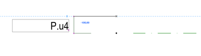

No, I would want the line follow the marker. The section line's hotspot remains at the point where we want the section itself to end, but the graphical representation of the marker should force the graphical representation of the line to continue beyond the hotspot.
Yves' marker is now -100 from the position where ArchiCAD "wants" the marker to be. You can see that the hotspot (am I using the correct term?) for the section END is correctly placed, but even then the section line doesn't go all the way to the hotspot. In other words, the section line shown in the floor plan is just a graphical representation manipulated by things under the hood and doesn't actually represent the true section line by which the section itself is drawn. You know that placing hidden semi-linked elements can lead the errors in drawings (you move a linked section and forget about the real section or vice-versa and then you have wrong views) and whenever possible, things should be linked within one element.
I mean, we do have grids staggering and they're not changing the grid line position, or are they? By logic from your post, we should have linked grids? Of course not, because grids don't generate views, but they are generated IN views, such as sections and elevations.
ArchiCAD 28 | INT - Cro | Forward | WIN 10 / 11

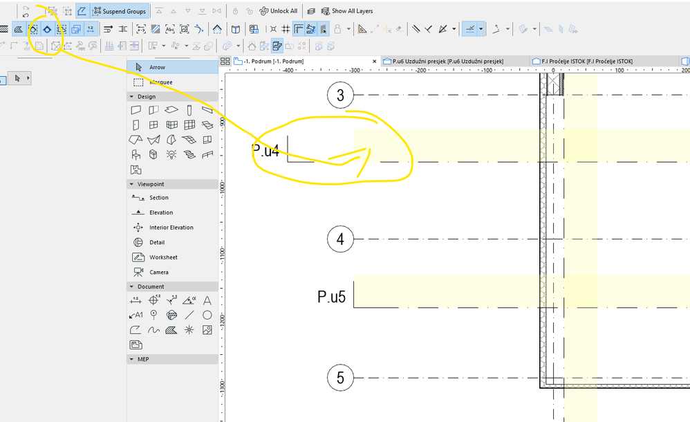

To furher elaborate, here's another screenshot:
With this display option turned on, it clearly shows where is the section line's end, but you can see that the graphical representation of the section line really ends early because it is dictated by the marker, not by the cut position.
I agree that linked sections are fantastic, and I use them extensively when doing formwork drawings (tens of sections per floor plan even for a small building) but I'm always anxious if I made a mistake when placing and drawing and naming and...
