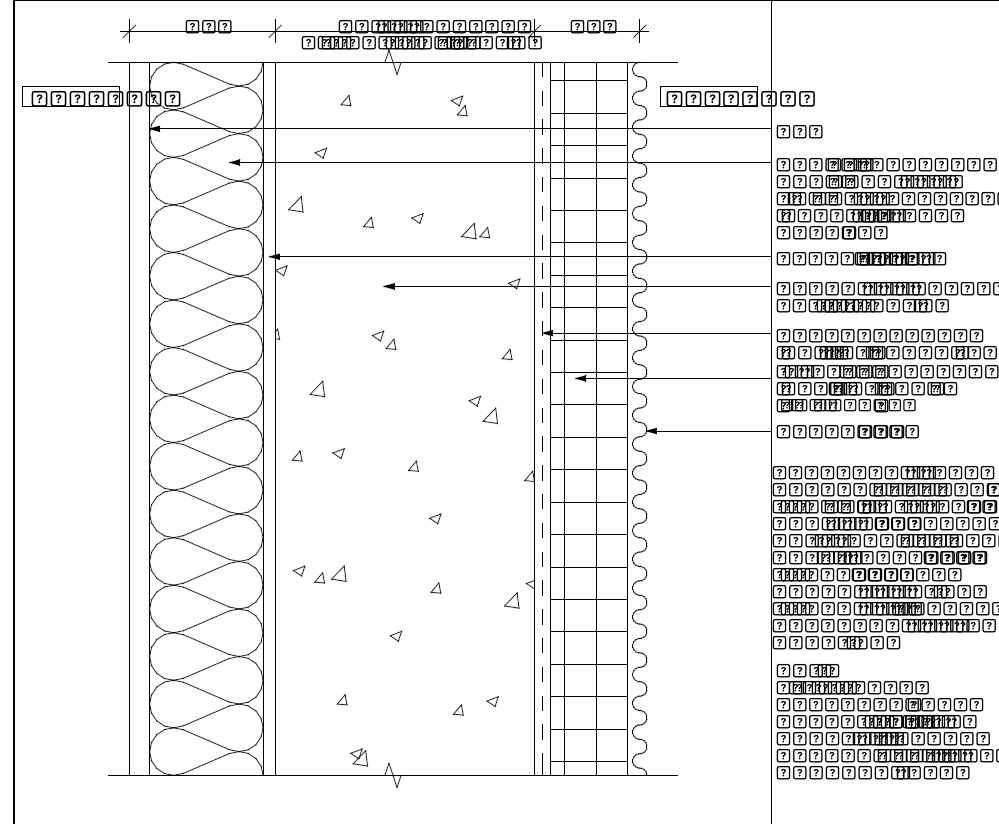

When I try to "explode into current view" a pdf of architectural details, the font appears to not be recognized. The characters come out as "?" symbols....
I believe it is a vector-based pdf, it came from another architect. I placed the drawing into a worksheet via the drawing tool as suggested by good practices.

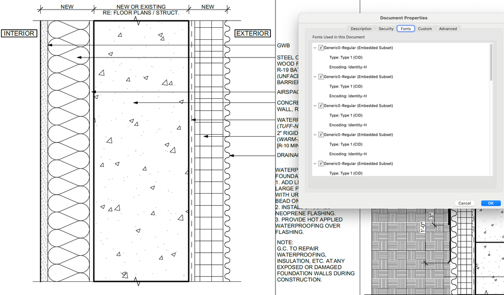

How do I identify the font and get Archicad to recognize it? When I open the pdf in Acrobat Reader, it lists the "Fonts Used in this Document" under Document Properties as "Generic0-Regular", "Generic1-Regular", "Generic2-Regular", "Generic3-Regular"... I've tried using online tools like "Whatthefont" to id the font in the pdf, but it simply returns MANY options, all for sale to me...
Is there a method I am unaware of to remedy this problem I'm having?

Molinda,
Thank you for the suggestion, but no, the "Use Uniform Font" option does not remedy the issue. I believe it has to do with Archicad simply not recognizing the font in the pdf.
Your other suggestions both would be recommended approaches. I was unable to edit the font in my pdf editing software, so I was unable to properly try that suggestion. It may be my technical limitations, or it could be that the pdf drawing simply has vector shapes instead of actual text.

What's the source of these PDFs?
I have come across several of these in my life – it's a deliberate scrambling technique, where the creator does not want the text to be copyable.
Usually it's a fake font generated, where all the usual letters are stored in the PUA (private use area) – it looks okay, but that's where it ends.
Try to copy the text from the PDF. If that also returns garbage, this is the case here too.
