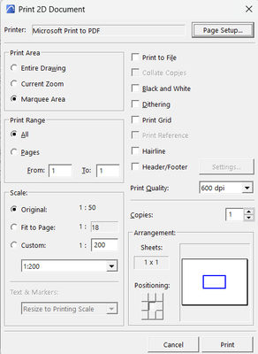

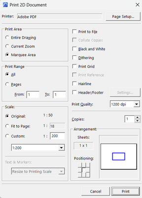

I have been dealing with an annoying issue recently...
When I export a PDF from ArchiCAD with Adobe PDF Acrobat DC, the transparent fills (as in this case, the shadows) become "dotty" or get filled up with little white squares. These are very noticeable in the output file.
If I export a PDF with the Microsoft Print to PDF option, this issue does not occur. I would be fine with the export using this option, but the maximum page size provided by this is A3... Which is sometimes not enough. That is why I started using Acrobat instead...
Has anyone ever faced a problem like this? Did I just mess up something in the settings?
I have provided pictures in both cases of the print settings and output picture.
