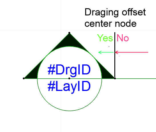

Check Eduardo's screen shot again (the yellow lines). You have to grab the center point while there is still a "jog". Works for me in AC16 (& 17)

Interesting exercise.
The devil or good is always in the details.
{as my typo in image} 🙂
Attachment shows the threshold point for dragging
the still offset section's center point node to the sides
to delete intermediate nodes.
Thanks All
