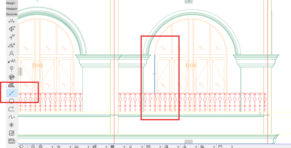

How can i draw Line tool by pick the line that i have link dwg in project?
I need to draw (Draft ) every single line by my self or every cure?

Apologize for my english.
1. I insert dwg drawing to project to draft 2D line for create morph (Image1)
2. I try to use Line command for automatic select from reference drawing
I would like to know how to select automatic pick line on reference drawing that i insert to project.

If you have placed a drawing, then it will be one single element.
However, if you want the individual lines, you can 'explode' the drawing.
Or Edit menu > Reshape > Explode into Current View.
