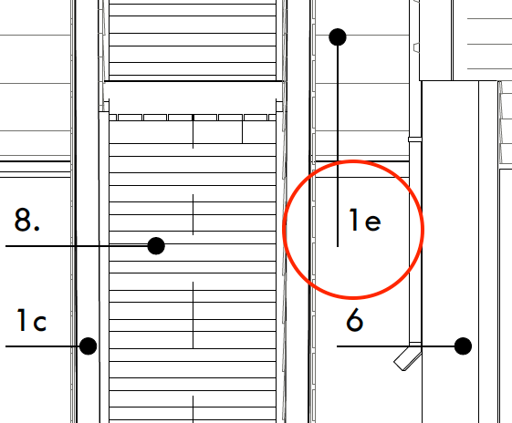

I am trying in vain to get a vertical leader for a label to show with horizontal text like in this screenshot. Everything I try keeps the text vertical also when placing the leader in vertical. Anyone know a solution? AC25

Hi Rene
I know maybe this is not the best solution, but it gets the job done.
I added an extra space before the text label and fixed the angles for text and pointer.

I was endlessly messing around with the settings, but your method with the space added works. Thanks Ricardo!
