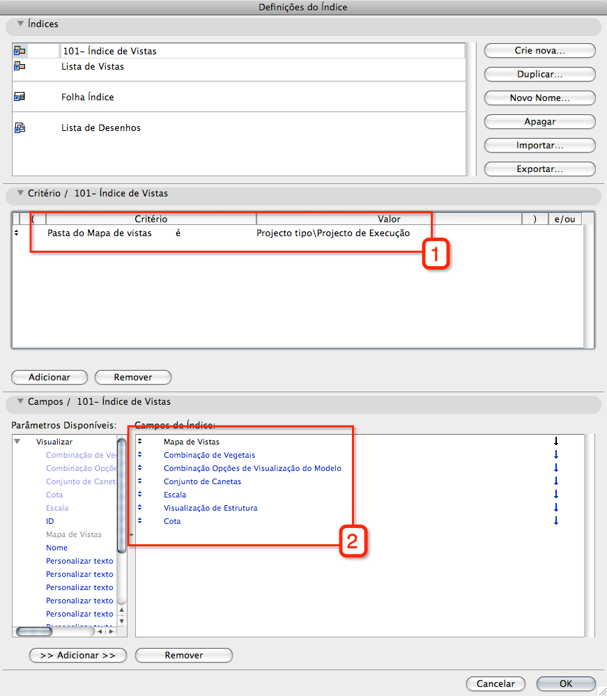

View Schedule
I don´t know if this is something that everyone uses, but I have been finding out there are a lot of people that don´t know ArchiCAD is able to produce a View Schedule where you can easily check and MODIFY each view's parameter (layer combination, view options, pens, scale, structure, etc.).
As your file grows, and there are more and more views produced, it gets sometimes a bit hard to keep track of all of them. This schedule allows you to take a look at all of them in one single page, and spot inconsistencies very easily (3 in the second image).
Once spotted, they are also very easy to correct.
Sorry that they are in Portuguese, but I think you get the drift.
First the schedule´s definitions, next the end result.
