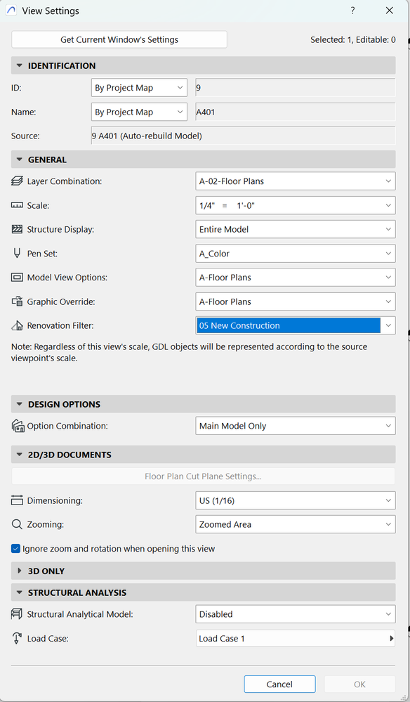

Hello,
Does anyone know why I cant hit ok in view settings?
Thank you!!

Hi @jo1111
It is a non-editable view. If you are working on a Teamwork project (BIMcloud) you may not have sufficient permissions for your user. Please consult the project administrator or lead architect.
M. Arch. Ricardo López
It is also possible that the element is locked, or it is on a layer that is currently locked. Layer states are stored in Views, so you may have activated a View in which the layer is locked.
