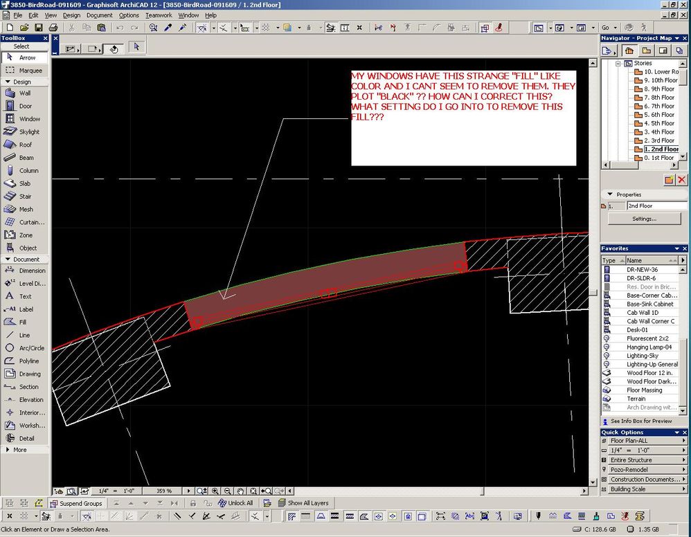

MY WINDOWS HAVE THIS "PINK" COLORED FILL TO THEM. THEY PLOT BLACK WHEN I PLACE THE PLAN ON A SHEET? HOW AND WHERE CAN I GO TO FIX/REMOVE/ADJUST THIS PINKISH COLOR EACH TIME I PUT IN A WINDOW??
(SEE ATTACHED IMAGE)

Don't shout with all caps. Open the settings box for the window and in the 2D plan view find the pink pen and change it to what you want.
Amazing you saw it in the dark with that black background
