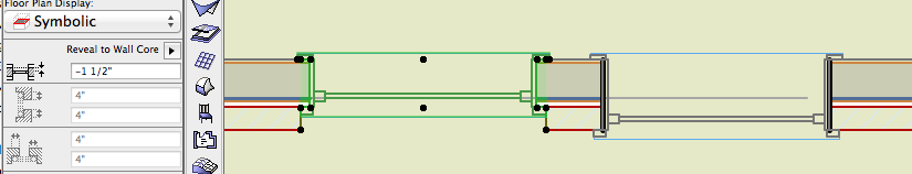

Is this a bug? In AC16 and before the Apply Structure's Settings Wall cut line used to affect the wall cut for windows and doors. I was able to change the line by changing the line in the settings even though it was turned off.
In AC17 that setting is now gone but I have a different problem. If the window or door is to the wall core and then offset I have a clean connection. If it is set to Wall Face or even Wall core but the full thickness of the wall I get the old Line 1 (Black and Thick) cut line at the wall cuts. Does anyone know how I can get rid of this in the Wall Face setting? I have attached images that show the line and the settings.
