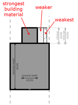

Hello,
I made complex profile for my fundation. In 3d view is ok, but in floor plan is not, for some reason lines won't connect propertly. If i change junction order in wall setting it does not help. Any tip?

1 ACCEPTED SOLUTION
Solution
Try checking the strength of the building materials you have used for the wills.
The main part of the wall needs to be the strongest, so they always connect.
The outer skins need to be weaker.

You could try putting faux layers on the outside that match the materials of the inside. PBI will wrap them instead of terminating them then. This works for Composites, though it prevents Surface Override of the relevant face, but I am not sure if it would work for Complex Profiles.
Thank you, that worked!
