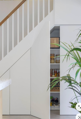

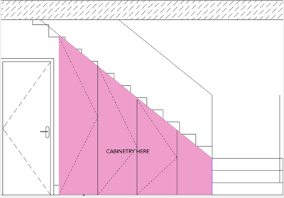

Is there a way that whether cabinetry tool/CI cab tool/ or even a DOORS be built that don't have straight top? See photo. I am planning on whether adding cabinetry or wine cellar under stairs.
I have very low expectation of Archicad quick resolution but I would prefer to work with a tool rather than modeling (which I can't do much).  😄 But I am sure someone has answer as I am not creating anything that havent been done before.
Thank you for navigating me.
And yes, in worst case I can do shopwdrawings but would prefer to have it nice 🙂

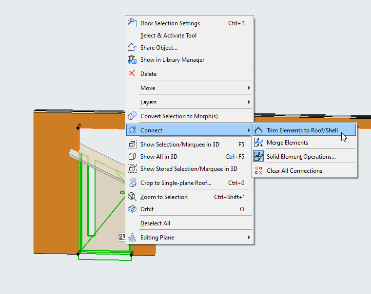

You can trim any door (or object like a cabinet) to a roof.
Place the roof in a layer you can turn off.
The door swing lines you will have to add manually.
