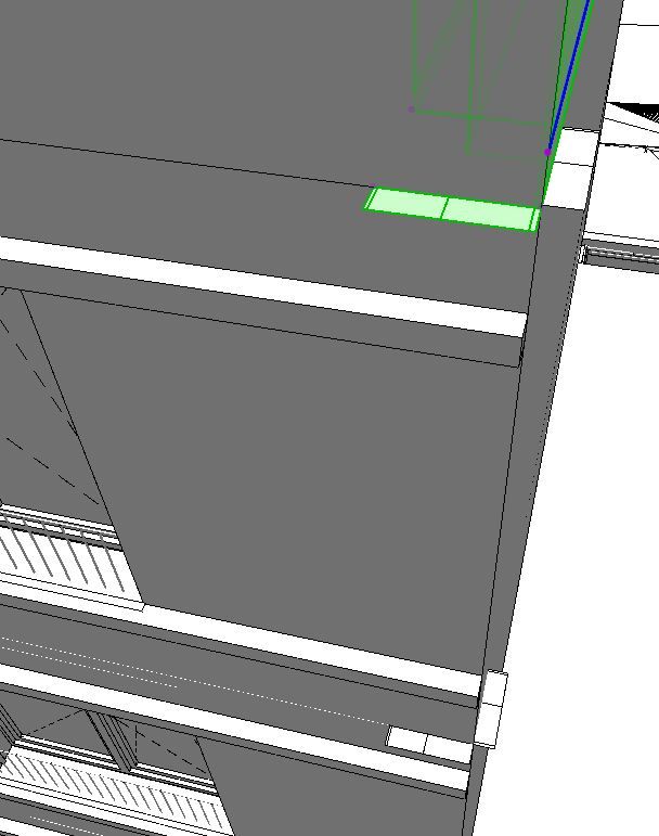

Hey Guys, i'm struggling with that extra part of the wall that is looking our of the edges. the walls are well connected. i tried editing the wall cosutme profile but it didnt work, does someone knows what can cuase this?
also, if were already in the subject, how do i make clean connections between slabs and walls? is there a workflow that can help me figure this thing once and for all?
Thanks in advance.

Check the height of your wall of the first image.  Probably there is an overlap between different walls on different stories.
You can try to delete the walls one story below to check which elements are causing this wrong connection.
About de slabs.  Draw the floors to the load-bearing part of the wall and not to the finish. Proper settings of the building materials will then ensure a proper fit.

Thanks cuba for your answer.
i probably did something wrong as the intersection was perfect beforhand. deleteing the wall beneath did not seems to cahnge anything. it looks like its a problem with the height though. somehow.

Check the height of the complex profile, I guess the complex profile is just a little to high causing the conflict in the connection with the other walls...
Can be off by mm...

Thanks, i solved it by editing the wall custom profile 1 cm higher.
Regarding the slabs and walls. would you draw in the same way a balcony?
