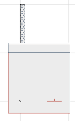

I have a little Issue I cant get behind.
The walls that should be under my roof in the cut floor plan, because they are, of course, under the roof.
I fiddled around with all floor plan settings, the general cut plane ones, and the object specific ones, for a while now and cant get anything to work.
I hope you can help. Thanks in advance!

One option is to give the Roof a Cover Fill, then use the Display Order commands to move the Wall under the Roof.

Thanks for your answer. The Roof already had a cover fill and the Display order commands sadly didn't work.
I suspect that it maybe could have to do with the fact that the walls and the roof are made from the same Material so the priority is the same?
I surely think that the fact the walls are trimmed to the roof doesnt help either.
Maybe you got another Idea :)?

Works here. What are the display settings for the Roof and Wall?
