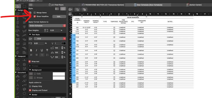

Weird bolded ID numbers in door schedule
Need some Schedule assistance for an issue that I can't find solutions to elsewhere.
Can anyone explain how I can go about removing the bolded numbers on the far left of this door schedule (highlighted blue)?
Context:
I believe the root of the issue stems from when we made a new renovation filter. We duplicated a plan status renovation filter and changed the name, and now the door schedule is showing these bolded numbers on the far left and we're not sure what's causing them to populate. They are not a relevant element ID. There is no apparent source for these numbers. When we turn off the element ID criteria the numbers are still there. What is going on?
3 Replies 3
CosminF
To me that seems to be the headline of the schedule. You can uncheck the function
Patrick M
its in a column set as a headline. You can either uncheck the headline, remove that column from the schedule scheme, or edit the headline text format to not be bold.

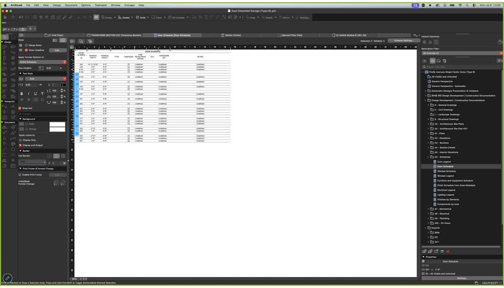

Is it possible that that first column in the Schedule is a hidden column with summing function turned on for it? (just guessing)
Can you show us the Scheme Settings Dialog (both criteria and schedule fields)?
