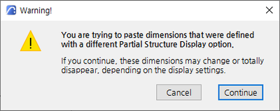

The dimension in the Entire Model is gone in Core Only.
Even with Ctrl+C and V, I couldn't send the dimension to Core Only.
What I don't understand is this.
Does that mean I have to redo all the dimension lines in Core Only?

yes it does 😀
Archicad 26, build 3001
Montenegro
Yes.
Each Partial Structure Display must be dimensioned separately.
In one you might want to dimension the entire width of a wall including the finishes.
In another you won't be showing the finishes, so there is nothing to associate the dimension to any more.
Hence you need to place new dimensions for each Partial Structure Display.
