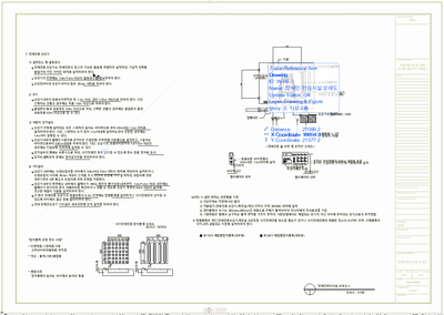

When you stumble through a lot of characters on your worksheet
LeeJaeYoung
If there are a lot of letters, if you select a letter and try to zoom in and out with the mouse wheel, you feel a stutter of less than 1 second.
I imported the same file into Revit, but it zoomed in and out smoothly.
Archicad was tested in worksheet and Revit in detail view.
P.S.) Even in Archicad, if you take the text to the floor plan and test it, there is no stuttering.
How can I solve this phenomenon?
If the text is small, as shown below, this is not a problem.
This test was done on ac25 and ac26
AC27 on window 11

the first screenshot looks to be like you've got a layout Trace Reference turned on.
this always slows down while moving around the view. by how much, depends on what you have in the active & trace views. selecting something seems to contribute to lag by a tiny bit, but not all the time.
it's not a problem in the second screeshot because it's in a Schedule.  you can't use Trace Reference in a schedule. but moving around a schedule can have it's own shortcomings.

thank you.
I didn't know layout Trace Reference could slow things down like this. ^^
