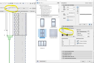

Window reveal to wall core
Johann_P
How can I set the Window to Wall core dimensions?
When using a "stud wall with siding" closure dimension is greyed out.
Do I need to make a change to the wall composite settings?

Ahmed_K
Mentor
I think you need to specify the core skin in the composite editor
