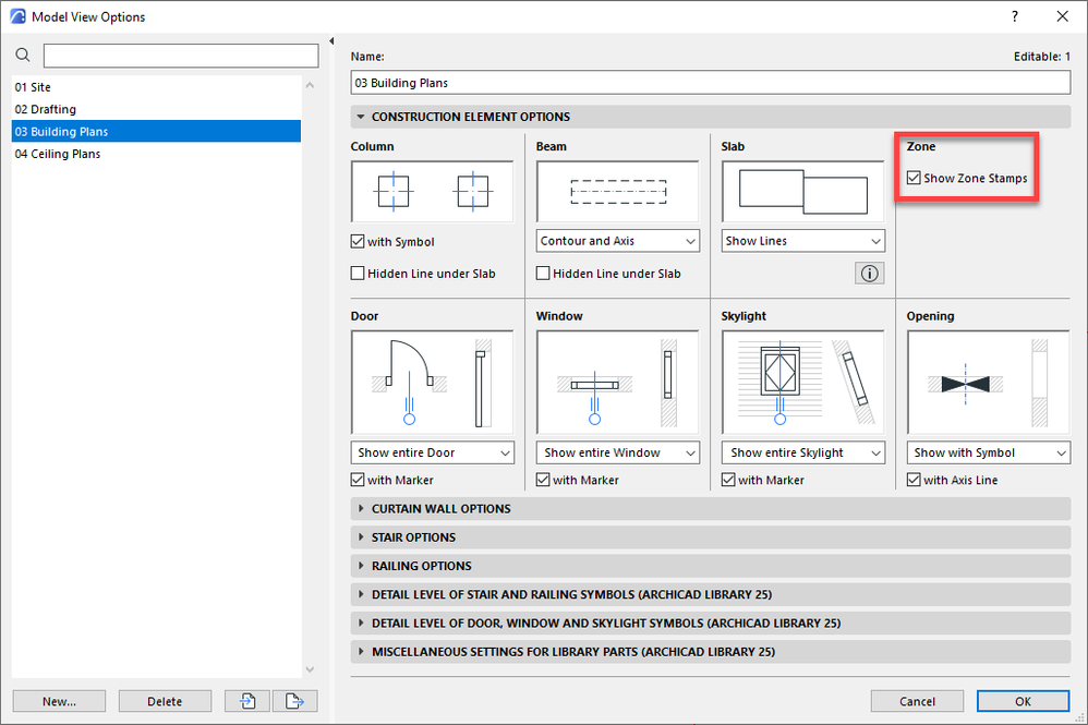

Turn this of before you place any zones.
And for any zones you have already placed, you can just delete the label.
And also make sure to adjust your Model View Option combinations so Zone Stamps are shown (in AC25 Update 2).
