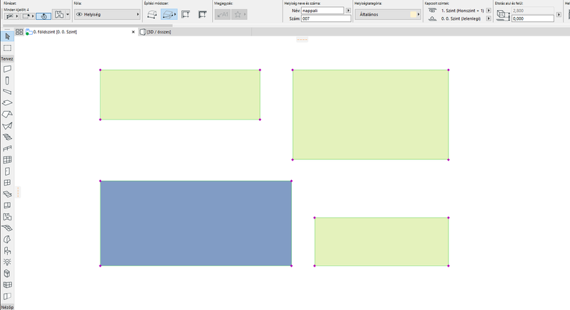

Hi everyone,
I would like some help on what could be wrong with the Zones? It places it in floor plan and space, but does not display any information about it. (room name, number, area, etc.)
If I turn on the label, it will drop an automatic label, but the basic information display does not work.
Does anyone know what the problem might be?

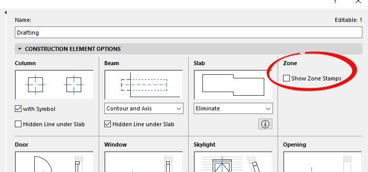

The zone label is the new way to show zone info.
You can turn the old zone stamp on in the Model view Options.
I think labels are better as to can have multiple labels in different layers and positions, showing different information.

That was the problem. Thank you very much!
